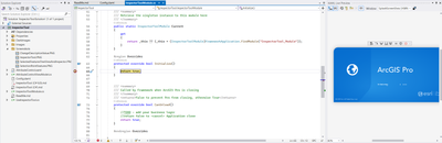

GKmieliauskas
Hi,
I have modified ArcGIS Pro SDK Community sample InspectorTool. I have changed autoload to true. It works as expected. Initialize event arises before ArcGIS Pro starts (on splash screen). Check project target framework (.NET8.0) version and  desktopVersion in config.daml file.
