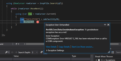

I'm trying to update a StandaloneTable through the SDK.  It is a .dbf file, in my map at the time of running the code.  I am using ArcGIS Pro 2.9.
I am getting the error on the row.Store() line.  I have tried to update my inspFile.Search(qf) line to inspFile.Search(qf,True), but then I get a "No Overload for method Search take 2 arguments" error.  Is this just a 2.9 issue??  If so, is there some other way to update the .dbf that would work in 2.9??
StandaloneTable inspFile = map.GetStandaloneTablesAsFlattenedList().FirstOrDefault(tbl => tbl.Name == GlobalVars.HydInspFile);
QueryFilter qf = new QueryFilter();
qf.SubFields = "FACILITYID";
qf.WhereClause = "FACILITYID = '" + shpFacilityID + "'";
using (RowCursor rowCursor = inspFile.Search(qf))
       while (rowCursor.MoveNext())
             using (var row = rowCursor.Current)
                  row["FACILITYID"] = sdeFacilityID;
                  row.Store();

The error I get is a GeodatabaseException.
So since at 2.9 the Search function doesn't really provide me a way to edit the rows, I guess that I just need to wait until we get 3.x pushed out to us by our IT department.

So I'm trying this on a Pro 3.0 machine, but still getting an error on the row.Store() line.  See below.  So when you tried this on 3.1 did you make any code changes to what I have above??
