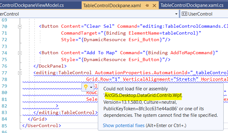

When I open TableControlDockpane.xaml in the TableControl latest 2.7 sample.
It says it can't load ArcGIS.Desktop.DataGrid.Contrib.Wpf ...
I then add a reference to C:\Program Files\ArcGIS\Pro\bin\ArcGIS.Desktop.Shared.Wpf.dll, and get this exception in the design window:
XamlParseException: Set property 'ArcGIS.Desktop.Internal.Framework.DesignModeResourceDictionary.Source' threw an exception.

It appears that viewing the TableControl in the XAML designer is throwing an exception when the TableControl is opened in Design mode. This issue should only have an effect on your add-in in XAML Designer, the TableControl should work properly in runtime mode.  I will report the issue to the developer of the control.  Thanks for reporting this.
