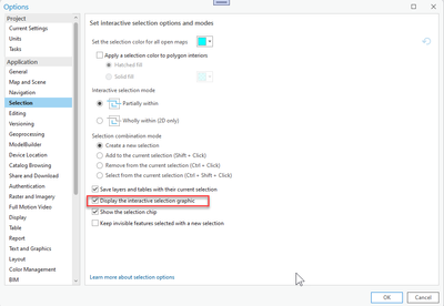

Just to clarify: This behavior requires the following options setting in ArcGIS Pro:
I was not able to get this to work either, i passed the question on to team.   I will let you know what we find.
