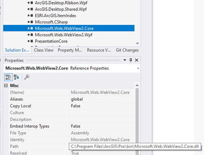

can you make sure you have the following assemblies referenced in your addin:
<ArcGIS Pro Install Folder>\bin\Microsoft.Web.WebView2.Core.dll
<ArcGIS Pro Install Folder>\bin\Microsoft.Web.WebView2.Wpf.dll
Then u should be able to access the webView2.CoreWebView2 property (and, from there, the cookie manager once CoreWebView2 is initialized)

Thanks for your reply, Charles. I was already referencing those assemblies but I was wrong about CoreWebView2. WebViewBrowser is indeed exposing CoreWebView2. I was mislead by the fact that that property is missing from the ArcGIS Pro API Reference.
However, I have tried both approaches described in the original post and none of them work.
