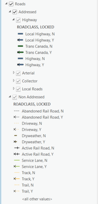

I have a block of code that creates a single selection object from the selections of each layer of a Group Layer. This worked fine in Pro 3.1 but now in the process of updating to 3.3 and it is failing with "ArcGIS.Core.ObjectDisconnectedException: 'This object has been previously disposed and cannot be manipulated.'" despite all objects having _disposed as false.
The original layer is a nested group layer, groups within groups. It fails when there are selections in both of the nested groups being combined.

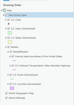

I tried your code with a collection of nested feature layers from a file gdb and I did not see the crash. My map group layers look like this screenshot below. Can you please give me a information on your layers?
