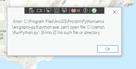

I have built the Add-In as instructed but I keep hitting this cannot open file error when running the Python script. The Python script does exist at the specified file path. I have tried moving the script to other file locations and building the file path string in different ways. Each attempt has either lead back to this same error or broken the build entirely. The error in Pro suggests it is adding an extra \ to the file path.
This is the value of myCommand in Visual Studio: /c ""C:\Program Files\ArcGIS\Pro\bin\Python\envs\arcgispro-py3\python.exe" "C:\temp\RunPython.py""
