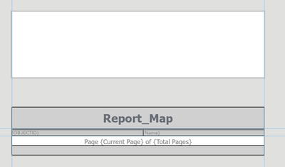

@UmaHarano I have created a report that contains some fields in the PageHeader and Details section from my source which is a standalone table. I have also added some dynamic text in the ReportHeader like ExportedDate, Page Number and also some static text. From share tab I then created a ReportTemplate an rptt file out of that report and saved in some folder.
Now using the sdk code present in the actual question I created ReportDataSource using the standalone table and list of fields. Then created the Report using the same data source and the custom report template.
But the report that is being generated doesn't have the ReportHeader section and list of fields that are present in the custom template. ReportHeader element that is present in that new report is just one element which is the report name. But if I will use the same custom template using the Pro’s report creation tool it is working perfectly fine.

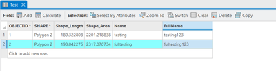

This is my data:

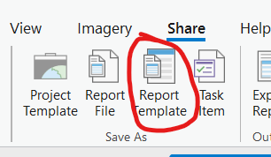

I saved this as report template:

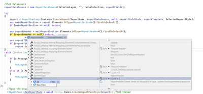

I fetched the correct custom report template but after creating the new report, the ReportHeader section is gone and its just one element. But it should be three: DateExported, PageNumber(Dynamic texts) and Welcome(static text)
This is the new report that is being generated. As you can see, now only one element in the ReportHeader is present named same as the Report name and all the ReportHeader elements defined in the custom template are gone. If you will closely see the fields as well they are same but the structure (spacing) is different. Since in custom template I defined my own spacing but when report was created from sdk it took some default spacing between fields.
