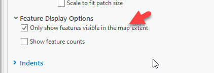

I am assuming u are referring to this setting....
which I am not personally familiar with but...if that _is_ the property u are interested in, with a bit of trial and error, it turns out it is this guy here: CIMLegendItem.AutoVisibility
This snippet toggles that AutoVisibility for all legend items. I noticed that the legend item property UI did not automatically refresh to reflect the "toggled" value but that is a bug (and I will relay that to the layout team). To update the UI I had to click on the legend and then back on the legend item.

FredB
That was it. Thanks !
