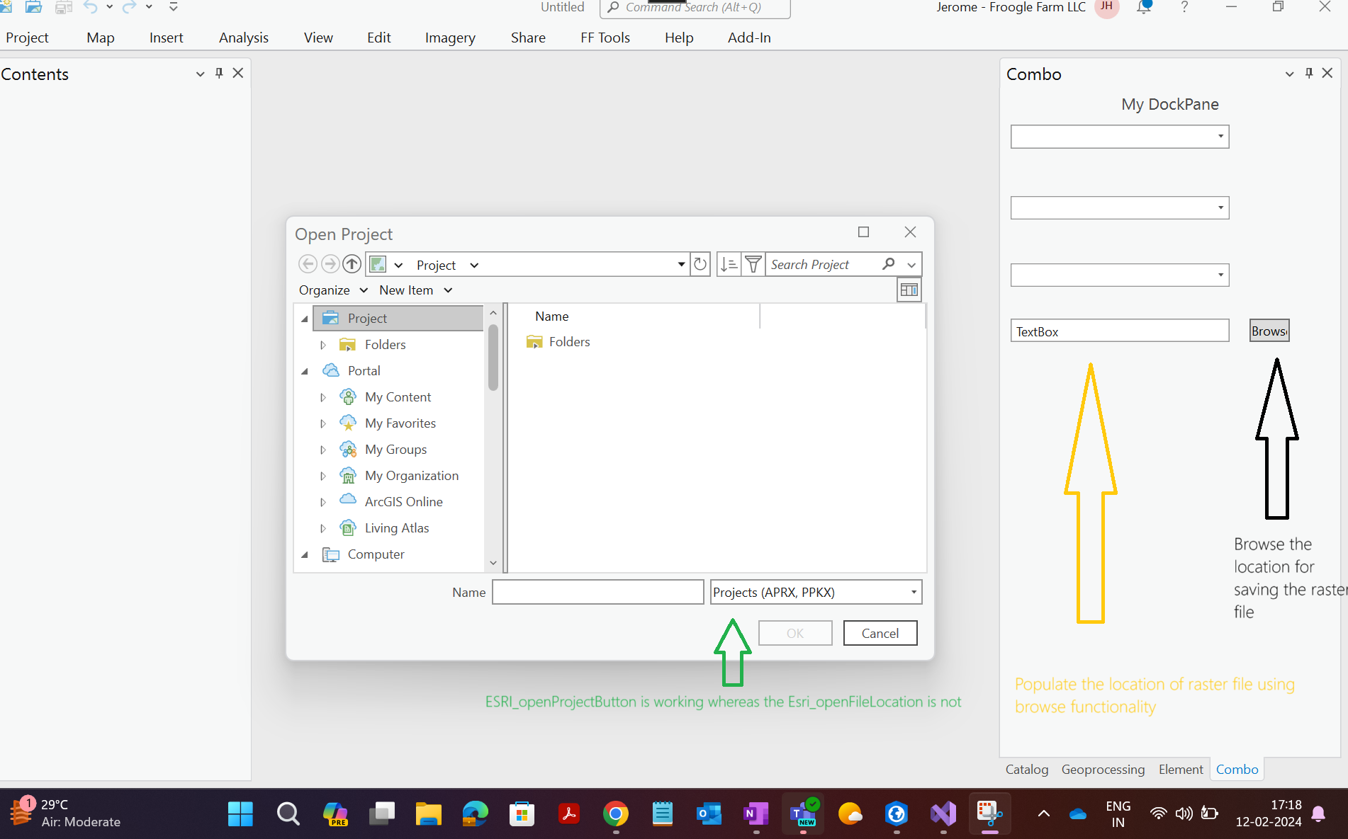

Hello Everyone,
I am trying to save/populate output of a raster file location in a textbox using a browse functionality button in Dockpane. However, I tried using the "show in file explorer" DAML ID reference "esri_file_openFileLocation" which is not working. Otherwise, if I tried using "esri_core_openProjectButton" it worked.
Can you please help me with the workflow or any suggestion?

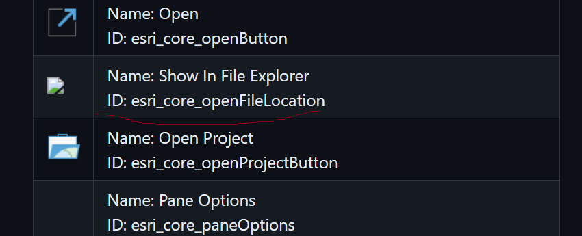

Thank you for sharing the information. I do appreciate your inputs. I have observe the list of DAML ids
 https://github.com/Esri/arcgis-pro-sdk/wiki/DAML-ID-Reference-ADCore.daml  .
My query is if I am able to use "esri_core_openProjectButton" then why not  "esri_file_openFileLocation"
GKmieliauskas
You use another id in your code sample: esri_file_openFileLocation. It is not esri_core_openFileLocation.
With esri_core_openFileLocation ICommand CanExecute with parameter null returns false. It means that you can't execute command. It could be that you need special type of object to pass as parameter for CanExecute and Execute.
AbhijeetNandeshwar1
Thank you for your response @GKmieliauskas . If you notice I have commented out the line No 7 which is esri_file_openFileLocation.
As I am in my learning phase of this technology, Can you please help me with the command for CanExecute and Execute in order to execute the esri_core_openFileLocation?
