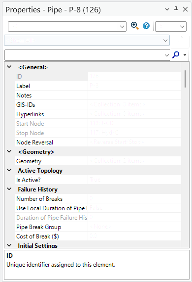

Here is our property grid:

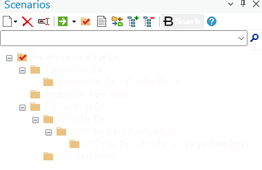

Here is our scenario manager (also note the color of the text in the "Search" button in the toolbar):
If you switch the theme in ArcGIS Pro to dark, then everything works correctly.
