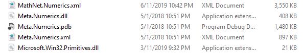

Good Morning,
I just upgraded to 2.4 today, and ran across an issue that I had solved in the past by manually copying a dll into the assemblycache\guid directory, but I'm wondering if there is a better solution? I am using the MathNet.Numerics library in my project, in addition to a number of other libraries. All of the other referenced libraries in the project seem to copy just fine. Below is an example of what I'm seeing when I look in the AssemblyCache\guid subdirectory. As you can see, it copies the xml file describing the assembly, but does not copy the assembly itself.
Interestingly enough, if I dig into the .esriAddinX archive generated by visual studio, MathNet.Numerics.dll appears to be present, and if I extract it manually using 7zip, the dll is extracted as expected. I tried deleting the assemblycache\guid directory, but when it repopulates, the same file is missing. Any ideas?

Matt, this is a bug. It will be fixed in the next release - 2.5

Sounds good, thank you!
