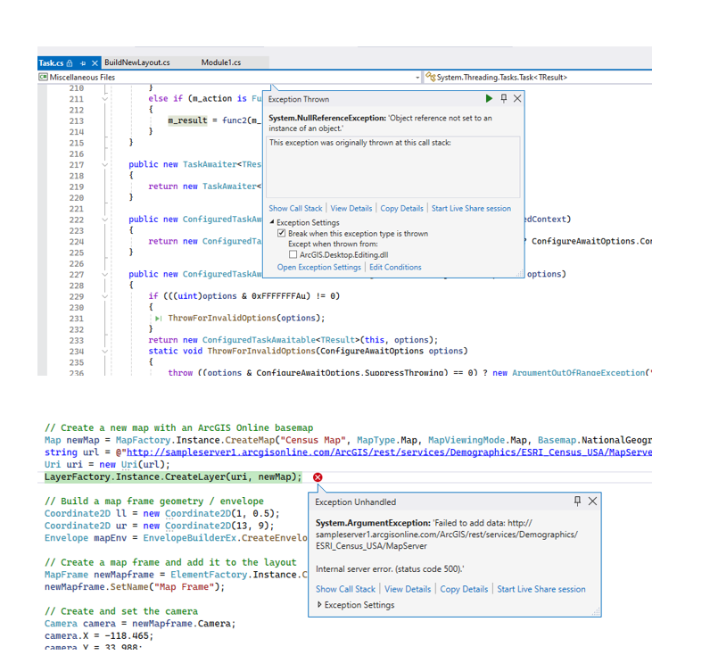

Even if I download the solution from that page, when attempting to run from Visual Studio 2022, I receive errors. Target framework is .Net 8.0.
The first error is a null reference - "Object reference not set to an instance of an object." - which occurs at the line:
newLayout = LayoutFactory.Instance.CreateLayout(newPage);
The second error seems to indicate that the Census Data map is having issues. Basically a server status code of 500.
Copies of these errors are attached.

RogerAsbury
Oddly, while I still get the "Object reference not set to an instance of an object." error, the view does load and I see the map with legend as expected. Thanks much for looking into this. 🙂

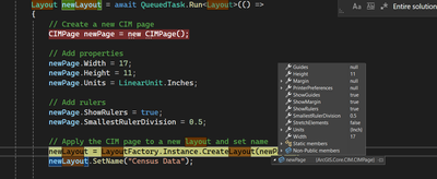

VedantBajaj
Running this code piece does not generate any errors for me. I tried running this on both ArcGIS Pro 3.3 and 3.3.1.
I have 2 suggestions which come to my mind.
1. Try cleaning/rebuilding the solution under "Build" options. (restart and try again if it does not work). Another option could be deleting the addin in ArcGIS Pro under Add-In Manager Tab on the Backstage.
2. Check the properties of newPage variable before the LayoutFactory Instance is created (Attached screenshot for reference).
