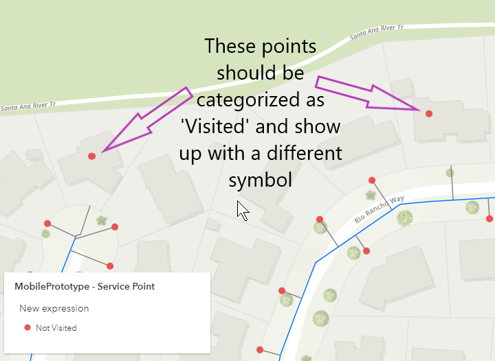

Ok GIS-ers. I am relatively new to Arcade, so please be kind!  I feel like I have been looking at this for way too long, and because of that I have likely been overlooking something incredibly simple...but I just can't figure this out! Help!?!?
Goal: To symbolize field data by whether or not it has been edited. Editor Tracking and Sync are ON
Approach: Use the difference between the $feature.CreationDate (when i published the data) and $feature.EditDate (this will be identical to CreationDate UNLESS the data has been edited) as the key to creating this symbology. I do have several data points that have been edited on different occasions, and therefore their EditDate and CreationDate attributes are different (verified this in table and in Console function).
Expression 1 & 2: Returns everything as 'Not Visited'
if ($feature.Creator != $feature.Editor){
var Status = "Visited"
return Status
else {
return "Not Visited"
__________________________________________________________________
if (DateDiff($feature.CreationDate,$feature.EditDate,"minutes")<=0){
return "Not Visited";
else{
return "Visited";
Not Separated

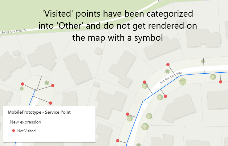

Expression 3 & 4: Only 'Not Visited' features were symbolized, 'Visited' features were clumped into 'Other'
Iif($feature.CreationDate != $feature.EditDate, "Visited", "Not Visited")
___________________________________________________________________
When($feature.CreationDate != $feature.EditDate, "Visited", "Not Visited")
Not Rendered

XanderBakker
Esri Esteemed Contributor
Hi Lindsay Spencer ,
Actually, I don't see anything wrong with your expressions. I did a test on ArcGIS Online and the results were correct using your expressions.  Since you posted this in the ArcGIS Pro SDK, I assume you are using ArcGIS Pro, so I also did a test to see if anything was different. In this case I used a Utility Network v4 in a FGDB, but the editor tracking fields seem to be named differently ($feature.CREATIONDATE, $feature.CREATOR, $feature.LASTUPDATE and  $feature.UPDATEDBY). However, after changing the names of the fields, your expressions worked just fine on my data.
It is very strange that in your case when two options are provided ("visited" and "not visited") a third is returned.
Would it be possible to have access to (a part of) the data?

KenBuja
MVP Esteemed Contributor
Just a minor change gives me the expected results. The DateDiff here will result in negative numbers as written, so change the evaulator, switch the position of the EditDate and CreationDate, or use the Abs function
if (DateDiff($feature.CreationDate, $feature.EditDate, "minutes") == 0) {
if (DateDiff($feature.EditDate, $feature.CreationDate, "minutes") <= 0) {
if (Abs(DateDiff($feature.CreationDate, $feature.EditDate, "minutes")) <= 0) {
