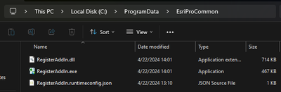

Can you please check the following on this machine:
  • Check this location to see if you see RegisterAddIn.exe - C:\ProgramData\EsriProCommon
  • If it is not there, is it in the Pro install location, bin folder?
Thanks
Uma
cdevault_pickett
@UmaHarano Looks like RegisterAddIn.exe is located in the ProgramData folder.
