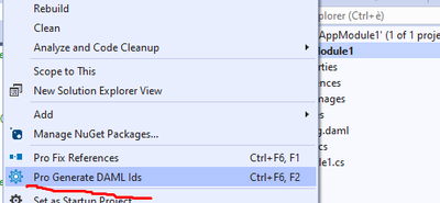

I've used the daml generate in Visual Studio project to find a condition with the post in it.
