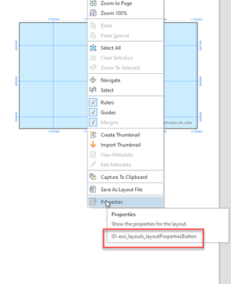

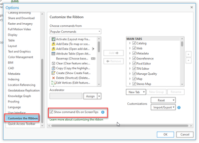

The reason why you get a <null> returned is because this item doesn't implement an ICommand (i.e. button).  If you use esri_layouts_layoutPropertiesButton instead of the property page DAML, your code should work.  To find the appropriate DAML Id you can either use the DAML reference here: DAML ID Reference ArcGISLayout.daml · ArcGIS/arcgis-pro-sdk Wiki (github.com) or you can enable the this Pro option:
Once enabled you can see the DAML Id as a tooltip:
