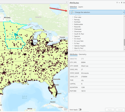

Are you referring to this attribute window?
If so, here is another approach -
you can create your own custom attribute window in Pro.  It gives you an opportunity to design your own UI component, while integrating the Pro user control (in your UI) that displays the attributes of the selected features.
Here is a sample that shows this: https://github.com/Esri/arcgis-pro-sdk-community-samples/tree/master/Editing/EditorInspectorUI
