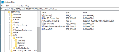

When you say, in my Add-Ins folder, are you sure this folder is set in the registry at HKEY_LOCAL_MACHINE\SOFTWARE\ESRI\ArcGISPro\Settings\Add-in Folders with a subkey with the path to the add-in?

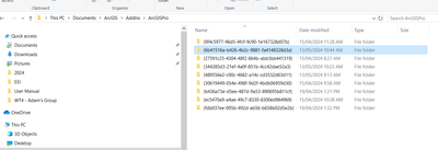

Yes, the AddIn is in the folder...see the image below, along with all the other ones I have converted.  It's just not showing up in ArcPro (all the other ones are showing up).
In my Registry, things are looking a bit different than in your screenshot, but if the other AddIns are getting added, I'm not totally sure that this is really the issue.  I think in ours you are using a custom location, where in mine I am just using the default location....I think that is why I do not see anything here.

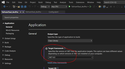

As for the Target Framework, everything looks good there.  The Migration Tool upgraded it to .NET 6.0, so all looks to be good there.
