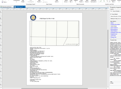

I'm not sure why that would happen. Below are images of the results:

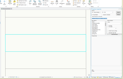

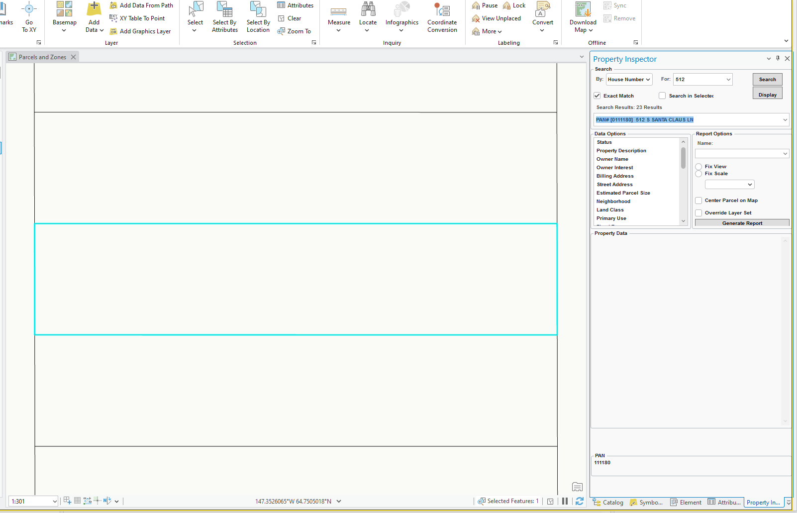

This is after the search, with the selected feature highlighted.

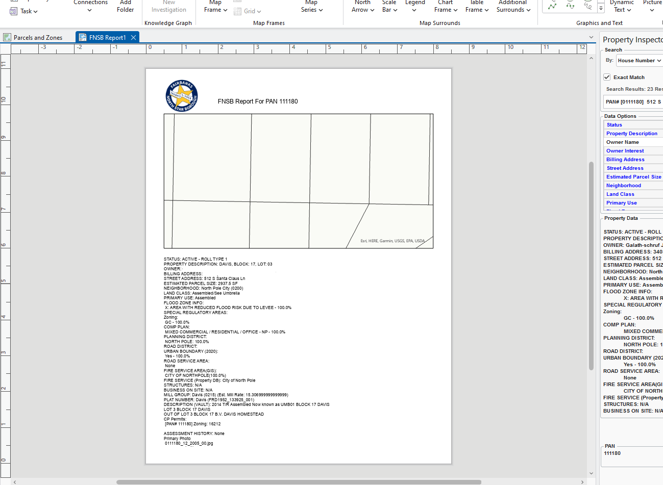

This is after creating the new view, showing a different area of the map, with no feature highlighted.

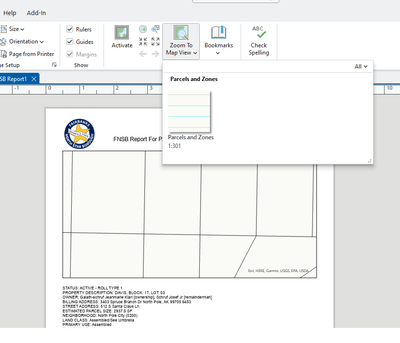

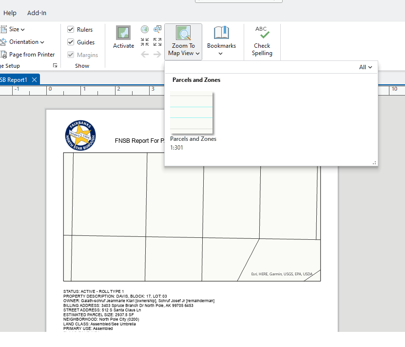

Edit to add: If I click the Zoom To Map View button, as shown below, it knows what the view should be...
