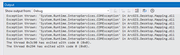

I have a maptool where I just place a marker on a map. Nothing else, no other business logic.
The marker is placed fine, however - when you look at the debug the amount of exceptions thrown from ArcGIS.Dektop.Mapping.dll is concerning.
What is going on here, should this be happening?

Hi,
I have copied your code and it works fine on ArcGIS Pro 3.0.3 and ArcGIS Pro SDK for .NET 3.0.0.36057

What Visual Studio are you using? I am on:
GKmieliauskas
Microsoft Visual Studio Enterprise 2022 (64-bit) - Current
Version 17.4.3
I think problem is in project or solution configuration.
Vidar
Where do you begin with this sort of stuff?! I did the migration process, but who knows if its done it 100% right. It would seem it hasn't ported cleanly.  I really don't want to start remaking all over project again.
GKmieliauskas
I have created new tool (with FooTool nam) in existing Esri community sample project (3.0), then copy/pasted your code inside existing FooTool class
Vidar
No I don't mean that. I mean my actual project/add-in. Its huge from version 2.x of Pro. If I have to start a new addin project and copy in all the code and start again - thats a real pain in the backside!
GKmieliauskas
I have solutions migrated from 2.x to 3.0, but I haven't issues like yours. Migration was painful to me too.
I have made all steps of migration documentation and repaired code changes.
Try to cleanup project. Check references of your project and etc.
