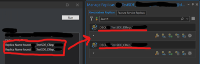

David_Lindsey
Thanks, Rich. That's too bad, but I'm glad it's on the roadmap. Is there a link for Pro SDK specific roadmap items that the public can track? I looked on the github site, but wasn't able to track it down if it's on there.
In this case, I was able to band-aid things by iterating the .sde tables to extract the information I was looking for. If I take the distinct ReplicaID values from the REPLICALOG table and match those to their matching ObjectID values in the GDB_ITEMS table, I can then use that table's Name field value to return each replica name. There is hope yet!

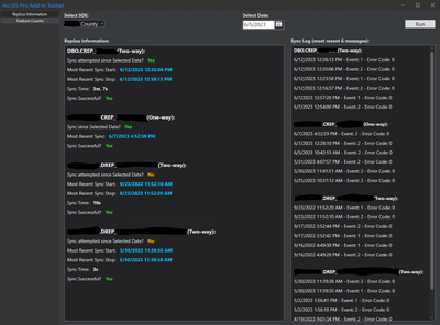

David_Lindsey
Thanks, Rich. Good to know! We have numerous Python tools in-house that deal with conflicts and sync, so it'll be nice to have that accessible across Pro SDK as well.  For now, I was able to create a work-around for the desired output for the replica lists. If I can build this in 2 weeks, I'm sure Esri could do it in 2 days with some focus. 😉
