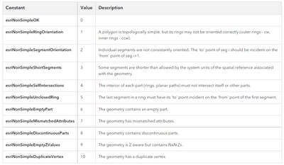

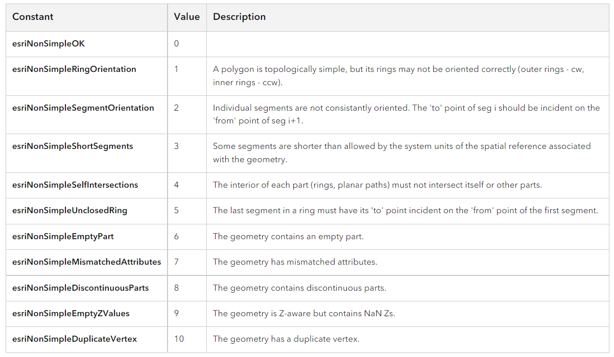

Does  the Pro SDK have anything like ITopologicalOperator3.IsSimpleEx found in the Enterprise SDK, that could  provide similar diagnostics, like this:
Thanks!
AnnetteLocke
Hi Kirk,
The Pro SDK doesn't have it, but we do have an issue in our queue to add it. I will update the priority to include it in an upcoming release.
