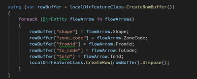

I currently use the following method to batch create elements
But this efficiency is slow.How can I be more efficient

Try using an insert cursor
API reference
Code snippet
I hope this helps,
--Rich
