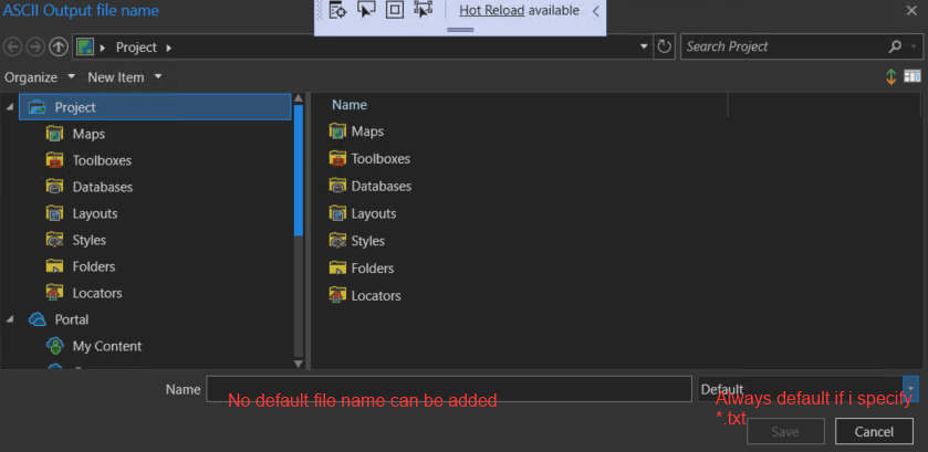

Hi Guys,
I am using this code.
SaveItemDialog tmpDestination = new SaveItemDialog()
                Title = "ASCII Output file name",
                DefaultExt = "txt",
                Filter = "*.txt"
            if (tmpDestination.ShowDialog() == true)
Normally with savefileDialog, I can use FileName property to add default file name for user, Is there any way in saveitemdialog?
And When I add Filter property, it display like "Default" in file extension below,  how to make it obvious like txt extension?

Thank Uma Harano‌,
It help for filter dropdown default, but How shall I add default file name in name textbox?
