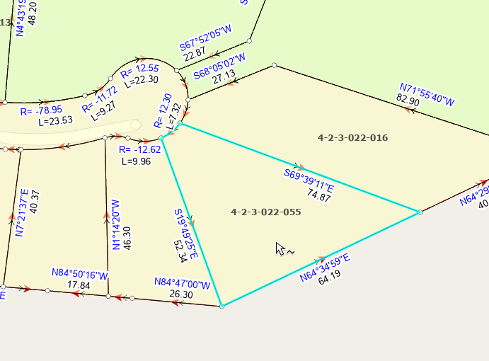

If I use the snippet above and select a single 'lot' parcel as shown here:
I get the following diagnostic output after the selected Lot parcel was copied into my Tax parcels:
CopyParcelLinesToParcelType:
Mapmember: Tax_Lines created: 7
Mapmember: Tax created: 1
