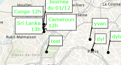

This is working. The result is my first screen, and i want to have different Label depending on the attribute value of each layer. How can i change my value here, like the SetSize(13) to SetSize(eachLayer.TextSize) or something like this. I think i have to do a foreach but i can't find on what object.
Thanks for your help

You update only first or default layer label class. You need to create new/update list of LabelClasses as in link   .
You can add label classes from symbology layers . Each symbology class will have label class. So you need to set each label class for text size, font and etc. Then you don't need directly to use attribute fields like text size or font.

Let's clear up your question: "Have different label for each layer in a FeatureLayer"
Do you mean "Have different label for each layer in a Map" or "Have different label for each feature in a FeatureLayer"?
If first case it is enough to do "foreach(entity in layers)" and set Symbol parameters for first or default LabelClass. But each your layer must have one symbol symbolization.
In second case you need using ArcGIS Pro create symbolization classes for your layer using subtypes or your layer attribute table fields save layer to lyrx. In your code apply symbolization from lyr file to layer then update LabelClasses. You can create and symbolization classes from code.
Simplest solution, I think, is to create lyrx file with symbolization and labeling using ArcGIS Pro and in code apply lyrx for layer only.

Yes i wanted to do the second case. I finally found that i can change my label style in Arcade by using Expression.
" <FNT name = '" + $feature.et1_police_txt +"' style = 'Regular' size = '" + $feature.et1_taille_txt+ "' > " + " <CLR " + et1_couleur_txt + " ><BGD " + $feature.et1_couleur_fond +" > "+ $feature.libelle +" </BGD ></CLR ></FNT > "
//And in the code I put this expression in the label class expression
theLabelClass.Expression = myExpression;
//myExpression is the expression at the begin of the code
 Now with the same layer i have different color, size, font... depending on the value of each entity.
