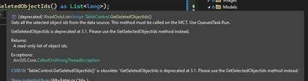

I am trying to get the selected row from a table.
I have created a TableControl objetc
private TableControl _tableControl = null;
And a method to fetch the selected row(s)
private async Task GetSelectedObjectIdsFromTable()
        await QueuedTask.Run(() => _selectedObjectIds = _tableControl.GetSeletedObjectIds() as List<long>);
The user can from a combobox select a layer from TOC and the content are showend in a tabel in a dockpane. But I can't figure out how I get the selected row from the table.
Visual studio give me a waring to the above method, saying GetSelectedObjectIds are deprecated in 3.1. But what do i use insted?

I just now noticed that the method you were using has been misspelled in its original version.  The correct method name is: GetSelectedObjectIds
The method you found as obsolete has the letter 'c' missing in Selected.  Apparently, the author of TableControl corrected the spelling and marked the originally misspelled variant as obsolete.  So you should be fine if you use the 'GetSelectedObjectIds ' variant.  Sorry about that.
