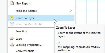

Zoom to Layer should use the extent, also:
