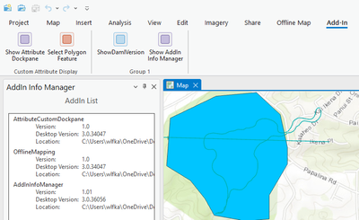

@AbelPerez , it appears that the AddinInfoManager sample was missing when we published the 3.0 community samples.  Sorry about that, but i added a 3.0 version of the sample and it appeared to work for me.  arcgis-pro-sdk-community-samples/Content/AddInInfoManager at master · Esri/arcgis-pro-sdk-community-...
