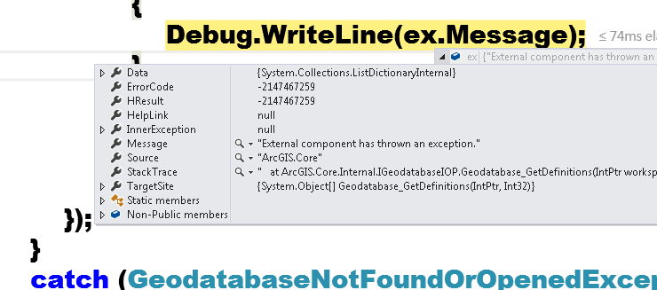

I am encountering an exception when I try to retrieve a read only list of RasterDatasetDefinitions from a file geodatabase using the GetDefinitions method.  The file geodatabase being accessed contains a feature class, a mosaic dataset and a raster dataset.
The GetDefinitions method behaves when retrieving feature classes and tables with no problem.
IReadOnlyList<FeatureClassDefinition> featureClassDefinitions = geodatabase.GetDefinitions<FeatureClassDefinition>();
IReadOnlyList<TableDefinition> TableDefinitions = geodatabase.GetDefinitions<TableDefinition>();
The following statement throws the error:
IReadOnlyList<RasterDatasetDefinition> rasterDatasetDefinitions = geodatabase.GetDefinitions<RasterDatasetDefinition>();
error

My post did not accept all of the content I had included.  I had attached a screen shot showing the output window showing I could evaluate the name and type of the feature class and the table requests.
Any insight regarding this would be appreciated.
