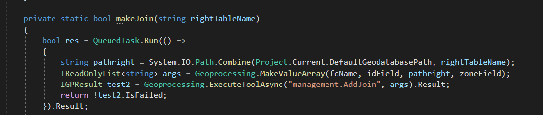

Hi,
I'm using a ExecuteToolAsync for join one featureclass and a table. I need to wait for the result to understand if it is good/bad.
The problem is that waiting for the result cause the ui to freeze forever. It seems like the Task doesn't retrieve the result.
What I'm doing wrong?

Hi,
ExecuteToolAsync doesn't need QueuedTask.Run. You can use ExecuteToolAsync with CancelableProgressor.
Sample here:
https://pro.arcgis.com/en/pro-app/latest/sdk/api-reference/topic9385.html

This might work:
private static async Task<bool> makeJoin(string rightTableName)
	var pathRight = Path.Combine(Project.Current.DefaultGeodatabasePath, rightTableName);
	var args = Geoprocessing.MakeValueArray(fcName, idField, pathRight, zoneField);
	var test2 = await Geoprocessing.ExecuteToolAsync("management.AddJoin", args);
	return !test2.IsFailed;
