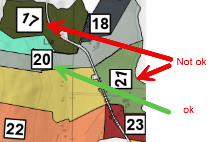

Is there a way to force labels added to a map to appear horizontal?
 return QueuedTask.Run(() =>
     var lyr = featureLayer;
     var lyrDefn = lyr.GetDefinition() as CIMFeatureLayer;
     CIMTextSymbol textSymbol = SymbolFactory.Instance.ConstructTextSymbol(ColorFactory.Instance.BlackRGB, 12, "Arial", "Bold");
     textSymbol.Callout = CreateCIMCallout();
     //Create the new label class and initialize props
     var newLabelClass = new CIMLabelClass
         ExpressionEngine = LabelExpressionEngine.Arcade,
         Expression = "$feature.id",
         Visibility = true,
         TextSymbol = textSymbol.MakeSymbolReference(),
         Name = "XX",
     var maplexLabelPlacementProps = new CIMMaplexLabelPlacementProperties
         ThinDuplicateLabels = true,
         FeatureType = LabelFeatureType.Polygon,
     var standardLabelPlacementProps = new CIMStandardLabelPlacementProperties
     newLabelClass.MaplexLabelPlacementProperties = maplexLabelPlacementProps;
     var lyrsLabelsClasses = lyrDefn.LabelClasses.ToList();
     lyrsLabelsClasses.Clear();
     lyrsLabelsClasses.Add(newLabelClass);
     lyrDefn.LabelClasses = lyrsLabelsClasses.ToArray(); //Set the labelClasses back
     lyr.SetDefinition(lyrDefn); //set the layer's definition;
     featureLayer.SetLabelVisibility(true);
GKmieliauskas
Hi,
Set additional property to maplexLabelPlacementProps:
                    PolygonPlacementMethod = MaplexPolygonPlacementMethod.HorizontalInPolygon
I would recommend you use CIM Viewer for that kind of investigation
GKmieliauskas
Hi,
MariusN
Works!
Will look into the viewer 👍
