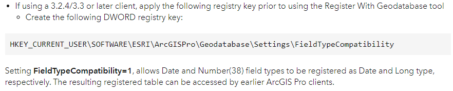

It could be due to incompatible field types. Have you looked into the tech support document for compatibility issues with Date or Oracle Number (38) datatype?  Try setting the registry key as described in the document and run the add-in; if the issue persists, please log a bug through the support team.

My worktables are using Date and Oracle Number (38) columns, so this at least sounds like the problem. I had been using Number(38) due to ArcMap Originally requiring that data type so I am assuming  now 'Long' is the preferred data type?
I was able to go though and add the registry key/value, this unfortunately did not resolve the issue.
I am currently running 3.2.0 though so is it possibly that I would need to update to 3.2.4 to try and resolve this?
