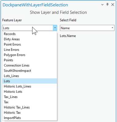

For anyone having the same issue, I made a few changes to the DockpaneWithLayerFieldSelection, but both ways work:
 internal class DockpaneWithLayerFieldSelectionViewModel : DockPane
    private const string _dockPaneID = "DockpaneWithLayerFieldSelection_DockpaneWithLayerFieldSelection";
    private ObservableCollection<FeatureLayer> _layers = new ObservableCollection<FeatureLayer>();
    private ObservableCollection<string> _fieldNames = new ObservableCollection<string>();
    private object _lock = new object();
    protected DockpaneWithLayerFieldSelectionViewModel()
      BindingOperations.EnableCollectionSynchronization(_layers, _lock);
      BindingOperations.EnableCollectionSynchronization(_fieldNames, _lock);
      LayersAddedEvent.Subscribe(OnLayersAdded);
      LayersRemovedEvent.Subscribe(OnLayersRemoved);
      ActiveMapViewChangedEvent.Subscribe(OnActiveMapViewChanged);

    public ObservableCollection<FeatureLayer> Layers
      get { return _layers; }
    private FeatureLayer _selectedLayer;
    public FeatureLayer SelectedLayer
      get { return _selectedLayer; }
      set
        SetProperty(ref _selectedLayer, value, () => SelectedLayer);
        FieldNames.Clear();
        if (SelectedLayer == null) return;
        QueuedTask.Run(() =>
          foreach (FieldDescription fd in SelectedLayer?.GetFieldDescriptions())
            string shapeField = SelectedLayer.GetFeatureClass().GetDefinition().GetShapeField();
            if (fd.Name == shapeField) continue;
            FieldNames.Add(fd.Name);
    public ObservableCollection<string> FieldNames
      get { return _fieldNames; }
    private string _selectedFieldName;
    public string SelectedFieldName
      get { return _selectedFieldName; }
      set
        SetProperty(ref _selectedFieldName, value, () => SelectedFieldName);
        Selection = string.Empty;
        if (SelectedFieldName == null) return;
        Selection = $@"{SelectedLayer.Name}.{SelectedFieldName}";
