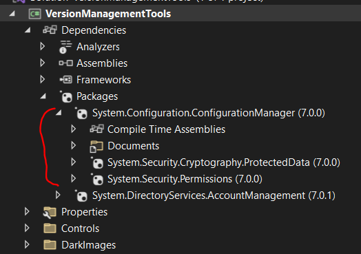

I have installed System.Configuration.ConfigurationManager via NuGet.

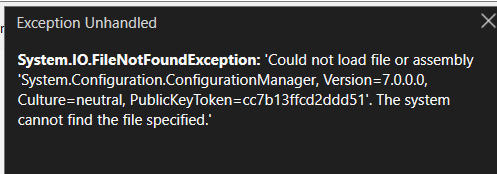

Error apparently being thrown from Module1 Initialize call.  The error details points to FrameworkApplication.cs
System.IO.FileNotFoundException
HResult=0x80070002
Message=Could not load file or assembly 'System.Configuration.ConfigurationManager, Version=7.0.0.0, Culture=neutral, PublicKeyToken=cc7b13ffcd2ddd51'. The system cannot find the file specified.

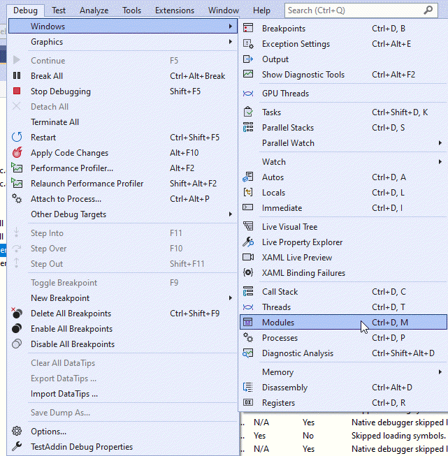

its a visual studio window accessible when u r running the debugger (see below). Sort modules on "Name".
>>Should I try downgrading my nuget package to 6x?
that sounds like it might do the trick

Where are you looking to see that info.
It does look like I have a 6x and a 7x version of the ConfigMgr dll.
CharlesMacleod
