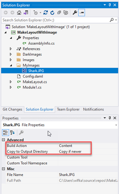

I tried this and found that the Url parameter for CreatePictureGraphicElement is limited as it doesn't support pack Uris as input.  I was able to get it to work by setting the 'Build' action for my embedded picture to 'Content' and the 'Copy to Output' to 'Copy if newer'.  This will unzip the actual jpg in my add-in folder as soon as the add-in is loaded by Pro and i can access the image via a 'local path'.
I attached my sample for your reference.

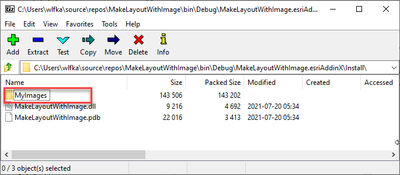

@GregG  It depends on the 'build action' that you specify in the image's properties.  Your property probably has a build action of 'Resource' versus 'Content'.  When you specify resource the image will be embedded into your assembly as a resource and is available under 'Resources...'.  If you specify 'Content' (with an appropriate copy action) the esriaddinx will contain the jpg image file under the folder structure you use in your project file.
You can verify that the image files get attached to the esriaddinx file by 'unzipping' the file and looking into the 'Install' folder.  You should see your jpgs under that folder:
