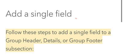

@UmaHarano Can u point me to the documentation or the code snippet? Because when I am trying to insert field value in the report header, Field Value is disabled in Insert tab. In the documentation  as well as the code snippet, it is mentioned that field value can inserted only in
GraphicElement fieldHeaderGraphic = ReportElementFactory.Instance.CreateRectangleParagraphGraphicElement(reportsSection, newHeaderFieldEnvelope, field.Name);

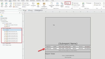

Field values for a attributes are only displayed in the "ReportDetails" section of a Report. In the Report UI, you will notice that the "Insert Tab> Field button (Data group) is only enabled when you select the "Details" section in the Report TOC. In the screenshot below, notice how I have selected the Details section in the TOC and hence the Field button in the ribbon is enabled.

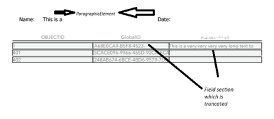

Dynamic texts when added to report header are not exported correctly to pdf. The value is exported as it is. So if dynamic text is {OBJECTID} it is not exporting object id’s value but exporting as it is which is {OBJECTID}
I am seeing wrapping issues as well for both scenarios: Details(fields) section as well element created using CreateRectangleParagraphGraphicElement
As you can see at the top there are 2 paragraphic elements but they are also truncated. As well as field values are also getting truncated (GUID and string values in 2nd and 3rd columns)

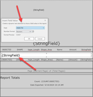

Regarding dynamic texts in the report header, the only dynamic tags supported are in listed in this help page: https://pro.arcgis.com/en/pro-app/latest/help/reports/dynamic-report-elements.htm
Anything related to features in the report data source are only relevant in the Fields section (ReportDetails). They cannot be used in the Header.
