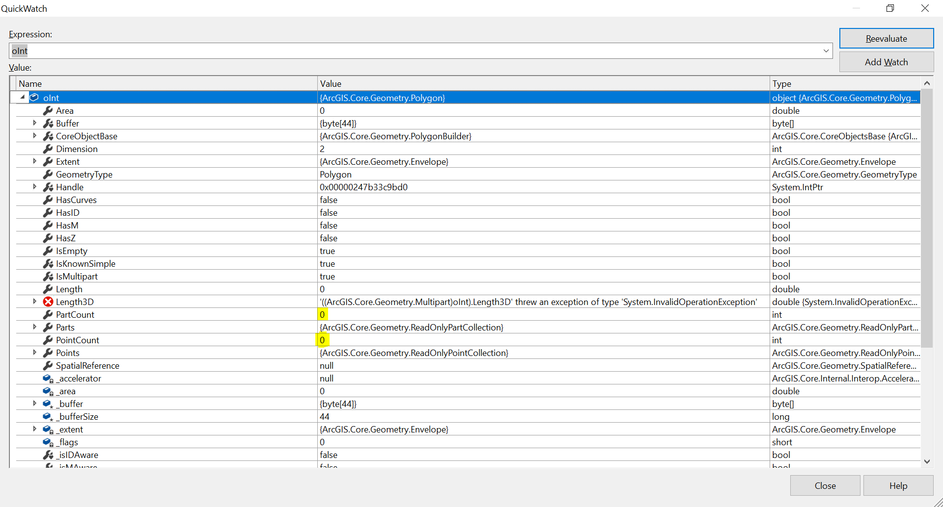

I have tried polygon intersection, where both the input geometries(and their vertex points) does not have any spatial reference defined which yielded no results whereas the polygon geometries should be intersecting

Thanks for your response. It resulted in an empty polygon with 0 points.

If the geometries are disjoint, then an empty geometry will be returned. Can you share your data?
