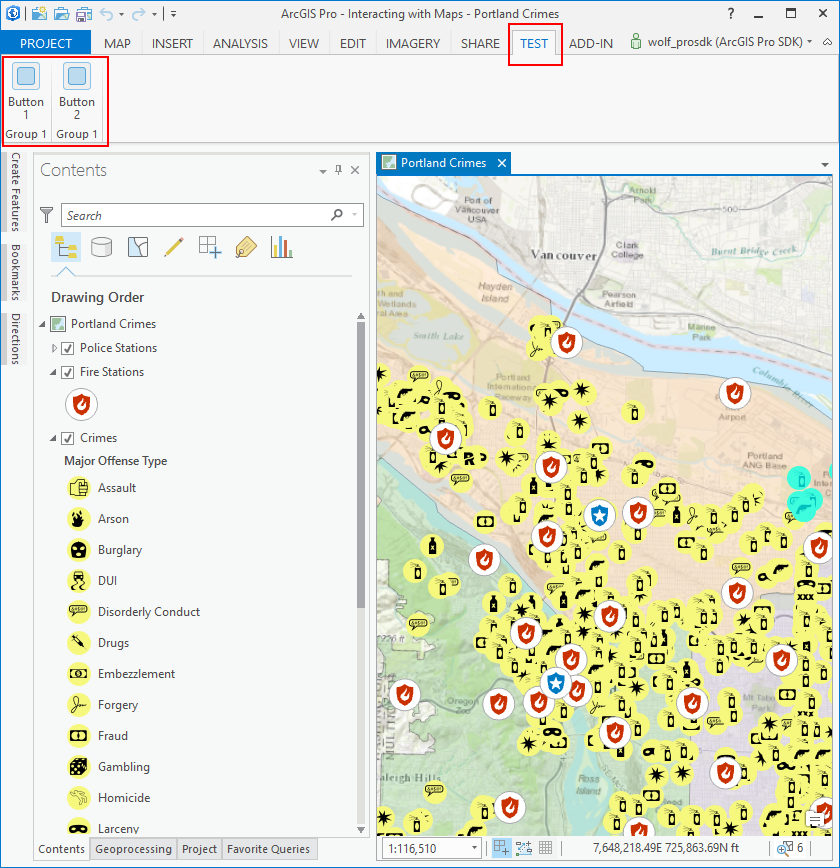

 The DAML change I made here updates my Test2_Module's UI (test2 is my add-in that is loaded first) by adding a new group to the already existing tab called test_Tab.  So now my two add-ins appear on the same Test ribbon as can be seen here:
Two add-in on the same tab
