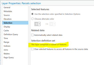

Is there anything in the API that can be used to determine (return a bool) if the "layer comprises a subset of features" as scene on the Selection Tab of the layer's properties here:

Thanks, Wolf.  This does appear to work.   Since I may have to maintain the code for my application in the future, I would like to fully understand what is going on here.
It seems to me that the underlying idea is that if a feature layer was created using "Make Layer From Selected Features" it's table will have a DefinitionSetURI.  Otherwise it won't.  Let me know if I am off the mark.
