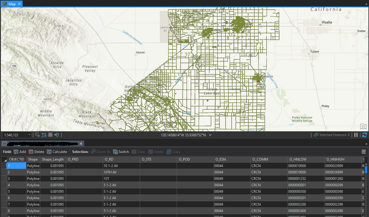

EDIT 3/19/2020:  Since it may be unclear what I'm attempting to achieve, the below image has the MapView and the open attribute table.  I would like for the selection of a row in that table to trigger an event in my add-in.  The MapSelectionChangedEvent is far too broad for this purpose, so if there is a SelectionChanged event or the like on the attribute table that I can hook into, that would work.  I cannot seem to find one, though.  I can select something from the add-in and have it show on the map, but I wanted to know if something existed on this built in control.
