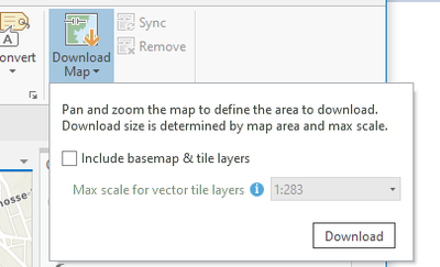

I'm looking to create my own custom menu from a button drop down like the "Download Map" on the standard Pro Map tab:
Is there a way to do this in the Pro SDK?  Perhaps using a supplied XAML template inside a button splitter or palette control?  I looked through the samples and don't seem to find anything. Maybe its not possible?

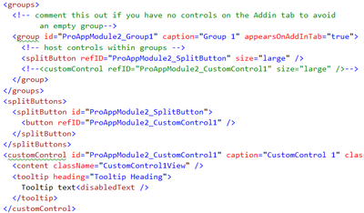

Yeah, the documentation is pretty sparse.  This works for me, but when I check/uncheck the checkbox on my control, it closes.  With Esri's download map control, it stays open when do the same.
XAML:
DAML:

KirkKuykendall1
Did you try putting a CustomControl inside a SplitButton?
See page 6 here:
https://proceedings.esri.com/library/userconf/devsummit-euro16/papers/devsummit-euro_30.pdf

KirkKuykendall1
XAML:
DAML:
JoeMadrigal
Ahh, seems straight forward now.  Appreciate it!

looking in the ADMapping.daml I see this:
<customControl id="esri_mapping_downloadMap" caption="Download Map" className="ArcGIS.Desktop.Internal.Mapping.Ribbon.DownloadMap" disableIfBusy="true" showHelp="true" staysOpenOnClick="true" isDropDown="true"
          <content className="ArcGIS.Desktop.Internal.Mapping.Ribbon.DownloadMapControl" />
</customControl>
Note the staysOpenOnClick and IsDropDown attributes. I think those are what you are after.
You can find the ADMapping.daml here: <your Pro install location>/bin/Extensions/Mapping
and here: https://github.com/Esri/arcgis-pro-sdk/wiki/DAML-ID-Reference-ADMapping.daml
JoeMadrigal
Ok, this is what I learned.  If I host the custom control via splitbutton, then the staysOpenOnClick has no affect.  If I put the custom control directly in the tab group, then it works as long as you also set the isDropDown to true.  Thanks @CharlesMacleod  for the hint and link.  This is exactly what they are doing in the download map custom control!
