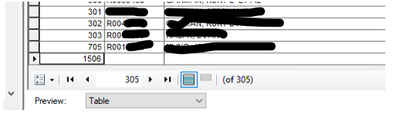

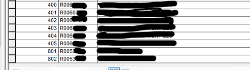

Creating a custom pane addin for editing a table of values.  However, the objectid's of the added values are far off from being the next number. For example, it goes from 405 to 801:

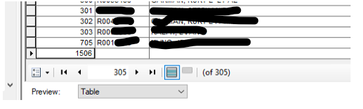

After truncating the table and restarting at 303, it goes to 705, then 1506:
Using the recommended process for creating a row in a table:
