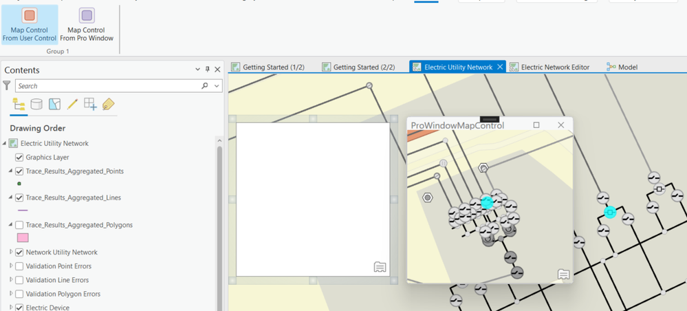

Within the zip is the small Addin with the workflow. I've added two buttons to the Addin as you can see in the attached image, one opens user control and the other opens a pro window. The pro window displays the map, the user control does not though.

It does work within a dockpane, but my intention is to add the user control that contains the MapControl as an overlaycontrol and this way the result is what we can see in the image I posted above. The map seems to be there but it is not being displayed, if you notice the button that shows the credits of the layer service is displayed, but where the map should be it is blank.
I did another test: I took the example you sent and added the UserControl (MapControlDockpaneView) as an overlaycontrol and the result was the same as in the example I sent. The interesting thing is that the map events remained working, so when I moved the extent in the blank window the main map was moved, i.e. the map is there as an overlaycontrol, but it is not possible to view it.
It seems that the problem is not the MapControl being inside a UserControl, but adding it as an overlaycontrol.
