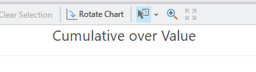

Then, when I open the chart to view it, the chart title reverts to a default value as if I'd created a chart from a table and did not specify a title.

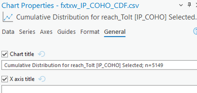

I can open Chart Properties and it indicates the correct title:
Then, as soon as I click in the 'Chart title' text area, the chart updates with the correct title.
I would think that the chart title should appear as intended without having to perform these extra steps.  Is this a bug?  Is there another step my code has to perform?
