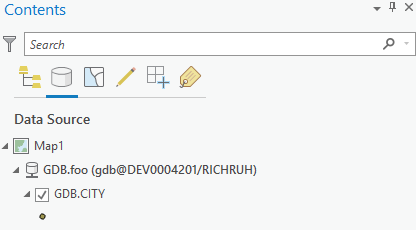

If you haven't done so already, I would take a look at toVersion.GetName() prior to calling Map.ChangeVersion() to verify that the value is expected.
Outside of that, I don't have any other ideas.  I set up an Oracle 12 environment that used classic versioning, and ran the sample code to switch the version from SDE.DEFAULT to the next version in the list (GDB.foo).  It all works correctly, and the Map refreshes afterwards.
