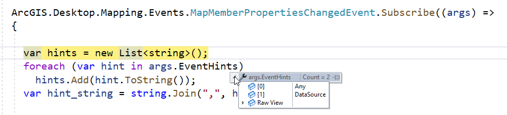

ArcGIS.Desktop.Mapping.Events.MapMemberPropertiesChangedEvent
event hints Any + DataSource.
MapMemberPropertiesChangedEventArgs.MapMembers had the changed layer entered twice. Presumably once for each hint.
