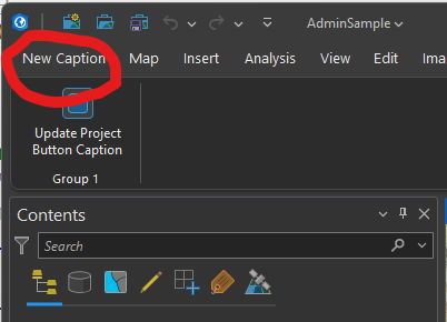

Indeed the "Project" button (as @UmaHarano  mentioned) is not a standard Framework Plugin (button) like the other tabs on the ArcGIS Pro ribbon.  But, since ArcGIS Pro is a WPF application, and you can 'spy' on the WPF visual tree (you can use Visual Studio to do so) to find which control implements the "Project" button.   I found that the "Project" control's name is "appButton" and the type of the control is "ActiproSoftware.Windows.Controls.Bars.RibbonApplicationButton".  Once ArcGIS Pro is open you can use the code below to update the "Project" button to "New Caption".  Note: since we can't access any ActiProSoftware resources the code below is using reflection to make the .Content property update:
// change the caption of the 'Application' button in the main window: appButton
string newCaption = "New Caption";
var mainWindow = FrameworkApplication.Current.MainWindow;
if (mainWindow != null)
  var appButton = mainWindow.FindName("appButton");
  if (appButton != null && appButton is FrameworkElement frameworkElement)
    System.Diagnostics.Trace.WriteLine($@"{appButton.GetType()}");
    PropertyInfo propertyInfo = appButton.GetType().GetProperty("Content");
    propertyInfo.SetValue(appButton, Convert.ChangeType(newCaption, propertyInfo.PropertyType), null);
In similar fashion you can update the Application's titlebar, but be aware that the titlebar is getting overwritten by project names.

@Wolf  @UmaHarano  Thanks for your help. This method is very flexible. 😀

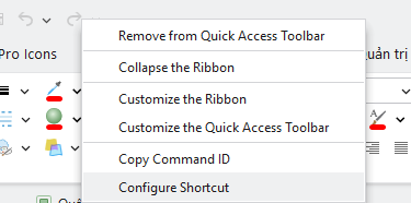

@Wolf @UmaHarano How to change Ribbon/QAT context menu? What DAML ID of this menu?
UmaHarano
ArcGIS Pro Configuration extensibility pattern can be used to modify the QAT.  More info here:
Cofigurations: OnCreateQuickAccessToolbar
