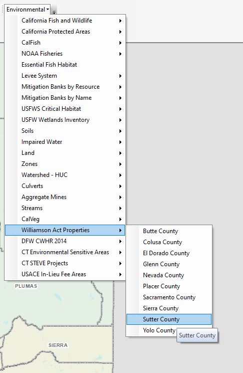

Hello All,
Within ArcMap, we could create a custom button, via python, to act as an organized catalog to add features to a map from a geodatabase. All the menu items were neatly organized depending on the category of the feature. This was a nice way to present the data because there is a lot to organize. In addition it would call up the feature class from a geodatabase and utilize the symbology from a specified layer.
Original Addin
Now i have created a very basic button in ArcPro to call up features from a specified geodatabase, however i can't find any information on how to organize the buttons into further dropdown categories or utilize layer symbology.
Any help on code or a point in the right direction would be incredibly helpful and I appreciate your time.
Thanks,
Derek Salinas

Its strange though, there is a section in the 'Insert' Tab that makes me think you can do a split button in a split button. Within 'Insert,' you will see the button 'Task' in the 'Projects' group is a split button that drops down to a regular button and another split button. I'm just not sure how to organize that properly within the code.
GKmieliauskas
Hi Derek,
Intellisense wrotes what elements of splitbutton can be button, gallery, or customcontrol. So your next level item must be customcontrol which acts as splitbutton.
It would be nice if Esri would implemented possibility to add splitbutton to splitbutton.
Maybe it is enough for Esri to expose existing their solution (you found) to public
But you can search internet for free or commercial wpf splitbutton and add it inside your customcontrol.
